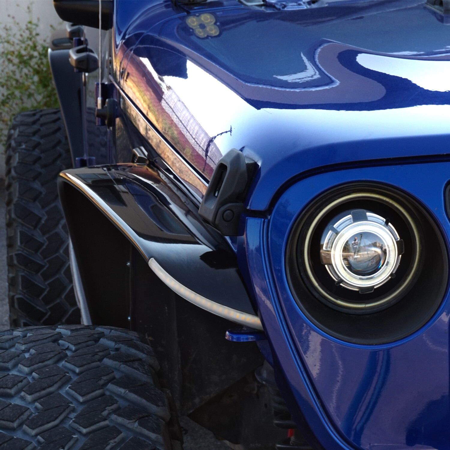

Have you looked at the Next Venture fenders? The ones I’ve seen on the owners rig and the lite brite jeep, the welds are a work of art. They are a bit wider, but also hi-line and I much prefer the turn signal/DRL.
Yep I definitely like them and looks like they are installed with AAL liners. I wonder what gauge the AL is looks thinner (which I like) the Morobilts were much thicker than I anticipated
Edit NVM is running a 15% off sale now
Nice setup. Color match painting would have to sorted out. If NVM makes there own liners to mate with fenders, that would be good. Pull the trigger time @WhiteBronze392
