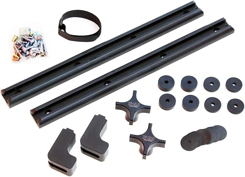

Fox adjustable ATS steering stabilizer. Another easy install. Mind the carriage bolt change (6510774AA)
