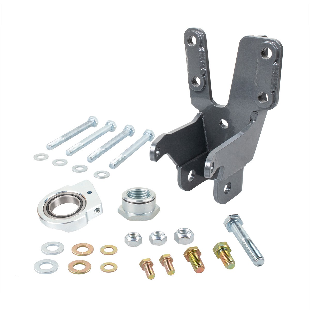

How does the Rusty's Trackball Bracket compare to The Synergy Bracket that also braces the sector shaft for the steering?
The Synergy is more than twice as expensive, but is it worth it?
I've got an entire Clayton Overland+ 2.5" kit waiting for my Jeep to get here, and it includes new trackbars as well as Currie's RockJock drag link and tie rod. I hate to chase problems I don't have, but adding the brace seems like it might be a worthwhile addition.
Awesome build, too, by the way! I'm envious of all you guys with your Jeeps!!
As for the end result unfortunately sorry I have no idea. It looks like it would brace it more but not sure if the difference is perceptible between the two maybe on bigger lift & 40's? TBH I probably wouldn't have shelled out over $300 to try it but $135 was a no brainer. Maybe someone who has installed the Synergy can give more perspective but to me it would be hard to tell what advantage comes from the frame track bar bracket vs the sector shaft brace.

As for the end result unfortunately sorry I have no idea. It looks like it would brace it more but not sure if the difference is perceptible between the two maybe on bigger lift & 40's? TBH I probably wouldn't have shelled out over $300 to try it but $135 was a no brainer. Maybe someone who has installed the Synergy can give more perspective but to me it would be hard to tell what advantage comes from the frame trackball bracket vs the sector shaft brace.

I think the Synergy Sector Shaft Brace/Trackbar Bracket is probably better suited to the early JLs that had the aluminum steering parts. I think the recall & and design changes to steel has alleviated a lot of this problem.
I agree though, adding a trackbar brace alone is probably a good idea. I'm not going to 40s, but I do have 37s waiting to go on.
