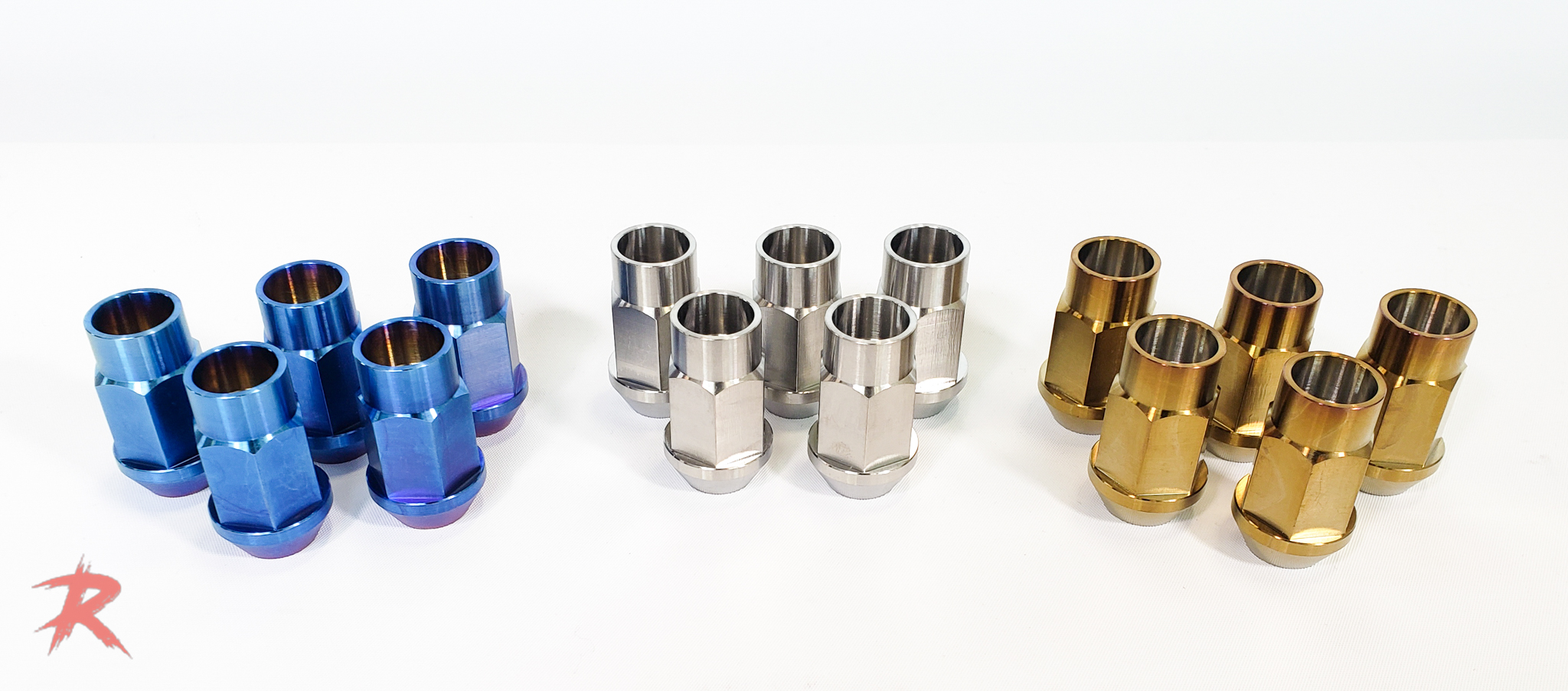

Looks phenomenal, definitely lots of goodies on this one. The lugs.... been searching around with some old car vendors I used to use back in the day but couldn't find anything. Saw yours...... I am assuming each set if 5 qty meaning, need 4 sets if not running a spare?
Thank you very much! I went through several sets of aftermarket lugs gorilla, splined etc that would just scratch and rust.
I believe this is them for a set of 20

Awesome set up. What seats are they? Do you have any other interior photos?
Ah it is for qty 20, nice. Was going to say they were a bit out of my reach if the price were 2xx per 5 lol.
Thank you ! They are KATZKIN Tuscany amaretto. Yes I will post some more. They look very different in iPhone pictures for some reason they are darker in person. I’ll see if I can capture some realistic ones
