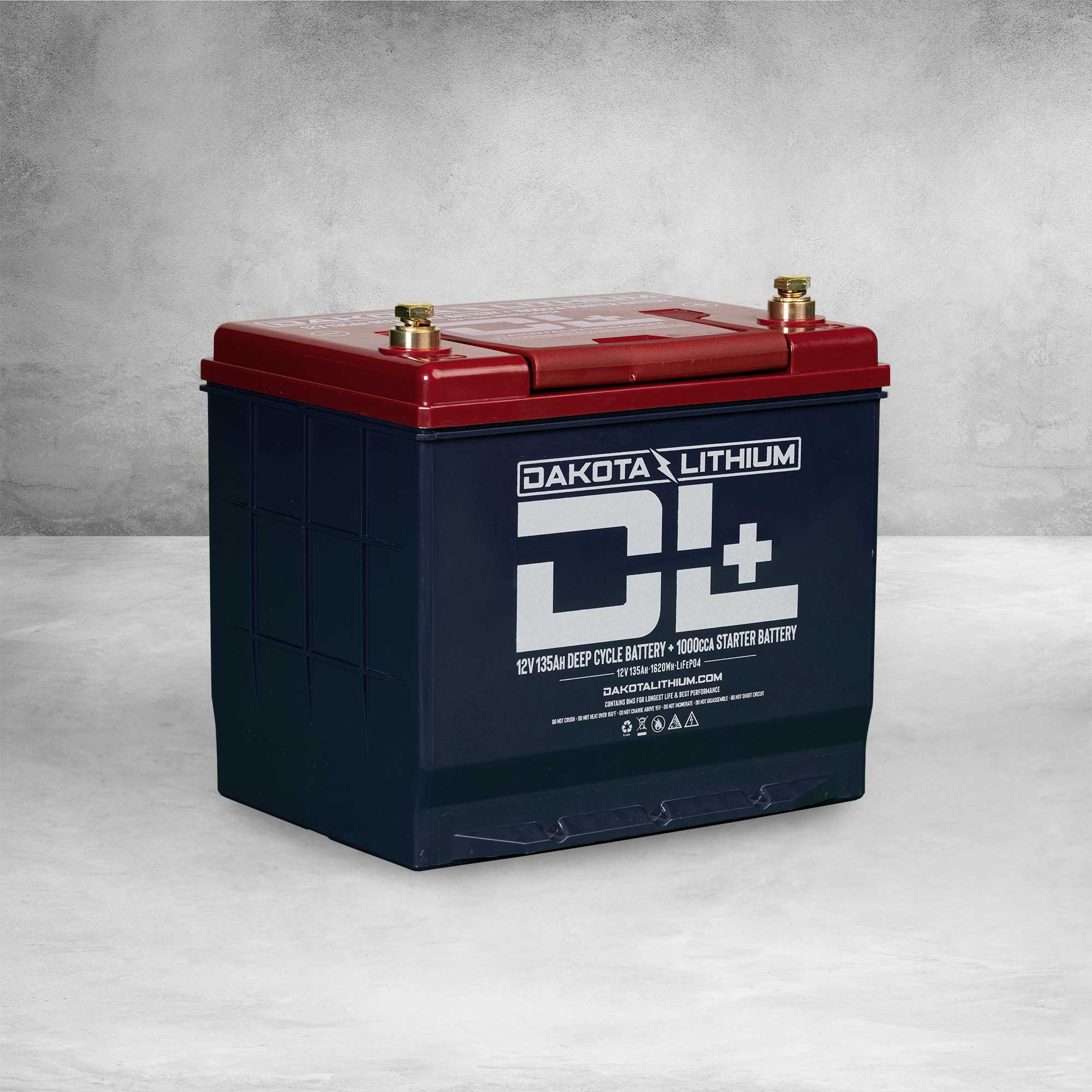

It seems that Dakota Lithium has a much wider temperature range for their starting capable battery, though there's probably fitment issues to consider.
OPERATING TEMPERATURE
Ideal for rugged & harsh environments. Much better than SLA or other lithium batteries. -20°F min, +150°F max optimal operating temps (battery performs well down to -20°F). Internal even-heat technology allows for charging below 32°F. BMS high temp cut off at 167°F / 75°C.
INTERNAL EVEN-HEAT TECHNOLOGY
Increases performance in extreme cold. When charging the battery in temperatures below 0°C/32°F DL's internal heating element will warm the cells to 0°C/32°F. This increases the lifespan, performance, and efficiency of the battery.
