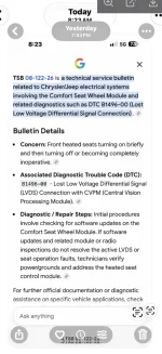

This is exactly the issue I’m having and the exact trouble codes being pulled up
