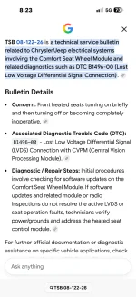

When you had your Tazer installed, were you using the setting that turned on both the driver and passenger heated seats?
This is exactly what’s going on. It was actually a TSB on it that they performed, but did not fix it.tbey also replaced both the heated seat module and camera module .

So I got a kind of an update from the Dealer. It’s in a holding pattern right now. It’s actually been escalated to Engineering. They think it’s a one off meaning no one else has ever had this problem and they have no fix for the solution as of right now, they think it might be software related so they may have to rewrite some software could take a week could take till 2027
