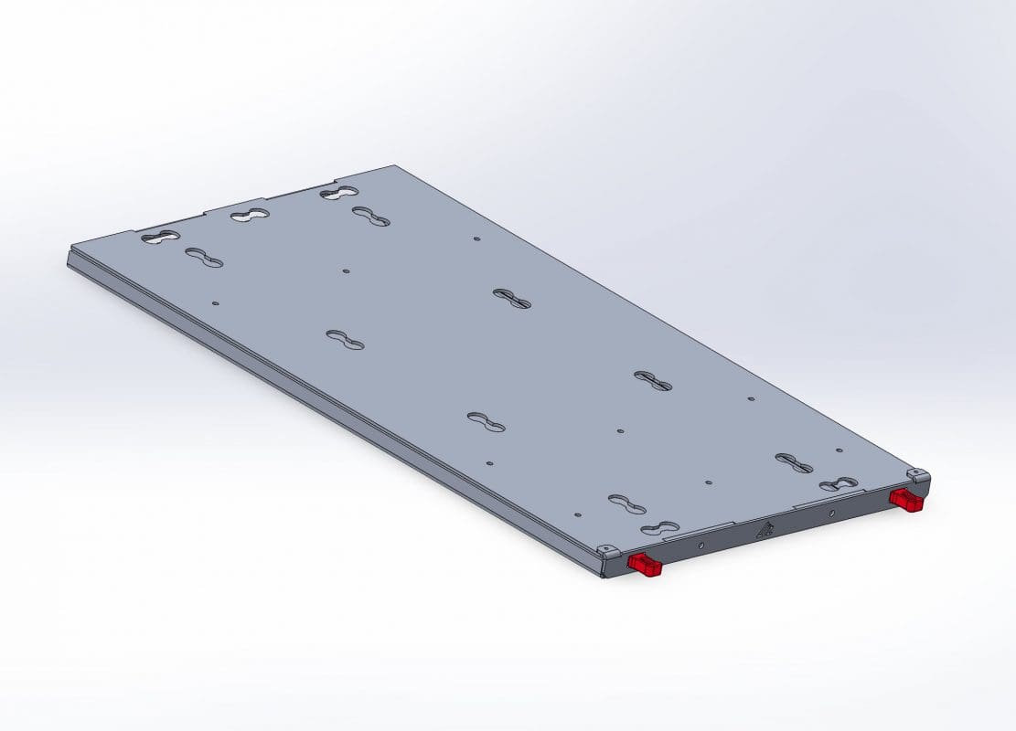

I have and do recommend their flat slide 6 x 4. I asked for it without the dog bone cut outs because I wanted to precisely mount my Dometic CFX3 45.
Do you see how your shelf roll cage brackets are connected to the back of the shelf when viewing from the rear. Mine is the opposite (instead of extending from brackets backwards mine extends to the front when viewed from the rear.
On a side note, I have that same cooler, can you please measure the width of ur slide? I need to build one by end of week for my overnighter this weekend on Mojave Road.

I had a dometic slide to begin with but was unhappy with it so I sent it back. Since it was built specifically for the CFX3 35/45 it had some cutouts to accommodate the mounting holes, feet, drain hole etc. I made a template on a scrap piece of hardboard. My template is the size of the fridge with all the cutouts the dometic slide had. 15 5/8 by 24 5/8 is the overall dimensions of the slide but it does not need to be even that big, the legs are represented by the 2 1/8" circles in the rear and the 2 5/32 x 3 9/16 ovals.
The AAL slide I have is 17.5 x 30.5. It is very nice and will slide out 28 inches.
Thats exactly the information I was looking for... THANK YOU!
And oh yeah... yes, with the shelf reversed (installed backwards) the rear seats will no longer sit upright. This of course isnt an issue for me since I had to remove them anyways for my Milwaukee boxes but most importantly, my Gazelle 4+ monster. Hence the reason I will be installing some hanging drawers from the bottom of the shelf.
