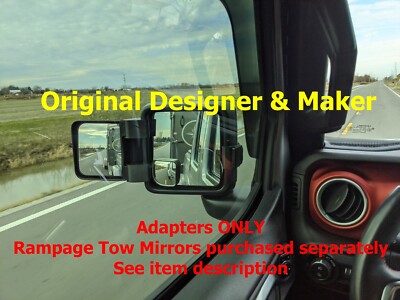

Also got the Rampage JK mirrors and custom JL adapters from thorn engineering. Fit is perfect, if you buy get them from the creator, not the copy cats!
