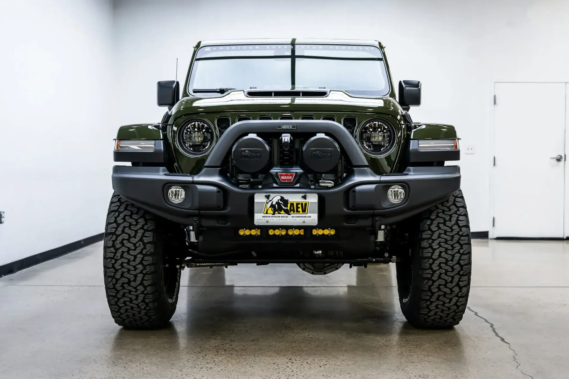

For my 392 though, I am taking it to a shop in Denver that one of the other members here used for his 2023 AEV conversion 392. He posted about his experience there, and the shop also wrote up a project page about it.
The shop I'm using this time is Denver Auto Shield. Here's a link to their page and the AEV 392 project.
