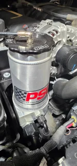

I'm running the PSC belt driven pump with the stock steering gear and no ram.
How do you like it ?is that the $1500 kit? More pictures please.thanks
Yes, I self installed the $1500 one. There isn't much to see once it's installed, the pump mounts where the idler pulley was, cooler mounts blelow the radiator. Steering is much lighter on and off road, it also reduces steering feedback from bumps in the road and rocks off road. You can hear fluid moving through the box at certain speeds but it's not annoyingly loud just something you hear sometimes. Overall I'm very happy with it.
