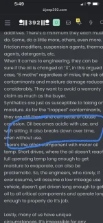

So where is the expiration date on the oil containers?
So buy oil like milk and make sure it’s fresh?
I have read other oil producers state that oil does not change over time so its strange to me to see an expiration date on the Penzoil but there is a date on the 6 quart boxes I have bought from Amazon.
That all have an expiration
I’d say it’s purely for making money. Just to get people into the dealers more often for oil changes. Usually the simplest answer is the correct one. I have had numerous hi performance cars from the factory with very high strung motors that only require at most 1 change a year. This is just a basic 6.4 hemi that is not high strung by any means of the imagination. You could go a year or two without an oil change (synthetic) and be perfectly fine. Will I go over a year no but you could. Black stone labs wrote up a good discussion on this a couple years back even saying a year interval is very conservative for most vehicles with synthetic oil.
