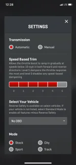

For off-roading and rock-crawling, I recommend using the Low Speed Trim settings. This reduces PedalMonster's added sensitivity below 10 MPH. The higher you set Low Speed Trim, the less it will add. As you exceed 10 MPH, it will add power gradually until you reach Sport 2, or whatever setting you left it.
For clarification, PedalMonster does not have a "Rock Crawling" mode like some other devices. This is on purpose. We do not offer any modes that reduce pedal sensitivity because it's dangerous. If the unit should fail, or simply revert to stock, you could lurch forward and rear-end someone. Or worse, you could send it off a cliff. Low Speed Trim is perfect because you get the best of both worlds... a stock pedal at slow speeds and modified pedal when you need it, at highway speeds.

Jay, thank you so much!
Obviously, we may be getting into personal preferences, but just to clarify: you believe the approach described above would be superior to simply returning the Jeep to stock when off-road?
Chris
Essentially, the Jeep will be stock at speeds slower than 10MPH. This keeps you from having to adjust the sensitivity every time you go on and off road. To recap, I'd keep it set to Sport 2, or wherever you like it for daily driving. Then, adjust Low Speed Trim to the highest setting. This will give you the best of both worlds.
