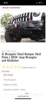

How much does the skid plate weigh. I might just 💩 can mine.
Not much. I'm keeping mine. Had it off to remove the bumper when I switched out the gold tow hooks.
