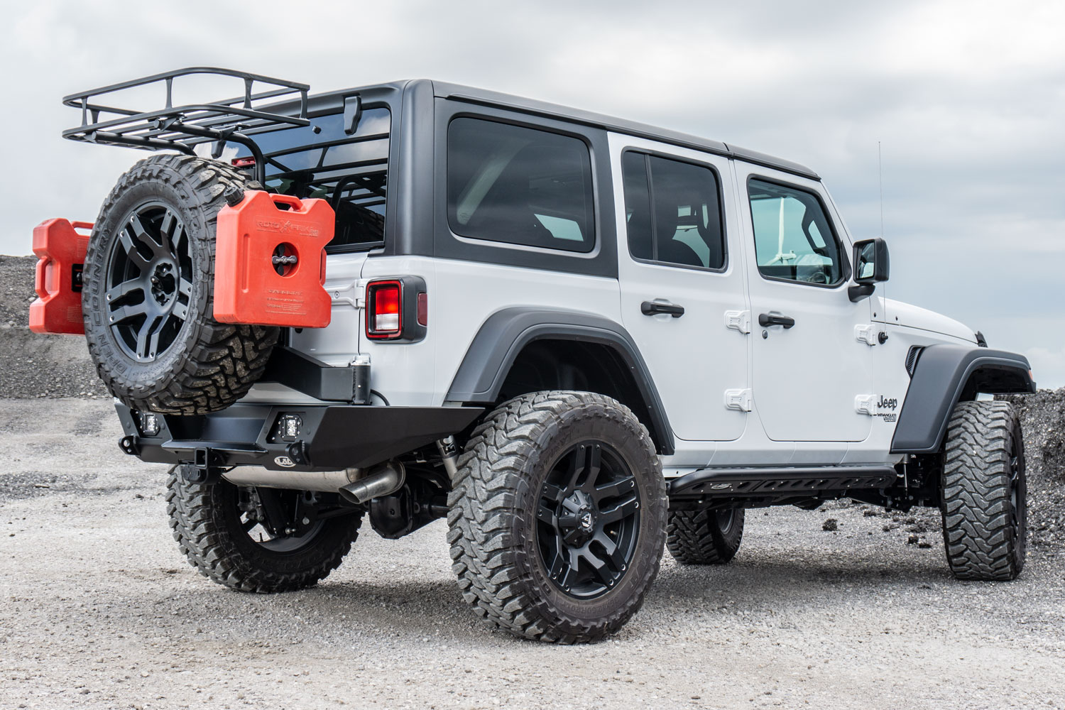

I haven't mentioned it in this thread but my LOD bumper has two Rotopax holders built in and is a great setup if you are thinking about a new bumper with a tire carrier.
This is not mine but gives you the idea:
31be0100-8057-11eb-8698-e759e87e4ab2
Now that is a clean and secure setup! ...except the low hanging plug.
