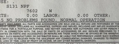

Picked up jeep today. Changed the oil and had them look at the smoke issue. The response, “no problems found, normal operation.” No idea what they did to troubleshoot. Thinking of calling the service manager to see. I guess I will wait for it to happen again and take it back.

It was overfilled. I bet it won’t smoke excessively with the correct oil level in the crankcase. They did nothing to diagnose it because they’re a dealer and they largely don’t care

A little smoke at startup when it’s cold is normal condensation. Constant smoking with an oil smell isn’t normal. He pulled the dipstick and saw it was overfilled from the factory. I bet with the oil change / correct level he’s good to go.

They drove it for a few minutes, didn't see any smoke and called it good. If you had photos or video of the smoke, that might spur further diagnostic work, but at a dealer, probably not. Good chance its due to the overfill on the oil.
To really make sure there isn't any blow by or other worse issue, a compression test on each cylinder would be the way to go. It could also be a defective oil seal, but I'd call that pretty unlikely.
Now that you have new oil, drive it, keep your camera handy and hope for the best.
