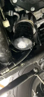

that is what I do. If you remove the the plastic drain thingy around the filter housing the 899 is a breeze to install.
Are you referring to that hose in the picture?
No, its the round black plastic shield towards the front of the vehicle, seen on the right side of the filter in that picture.
