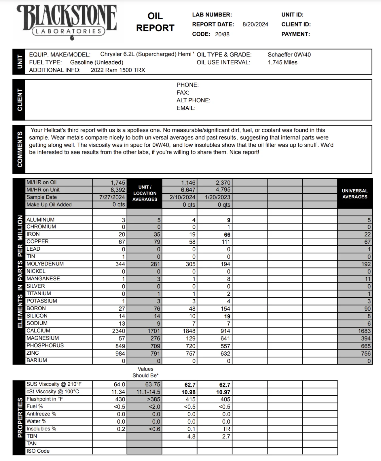

For those sending off oil samples, who do you use to test it? Do they provide special collection containers? How big of a sample do they need?
Thanks.
Thanks.
I use https://www.blackstone-labs.com/. They will send you collection containers and packaging/shipping materials. You fill up the little jar they send you while changing your oil and mail it to them. You can also send in your own container, but they don't charge you any less, so I use theirs to make it easy.
Thanks.
I use SPEEDiagnostix. The sample size is 3 oz. and is collected while the oil is draining (I believe @ ~15 sec. mark, IRCC). They provide you the sample collection container and a pre-paid return shipping box is included. Ideally you should use their sterile container to prevent any additional contamination.
I can't tell you how many oil changes has been done off the top of my head. My 2022 has 79,000 miles on it and the interval of oil change is done using the oil life gauge at 5% to 1% since day one. I obviously don't come any where close to the six month standard.
I made a comparison of oil labs for the TRX forum. Bottom line: will use Amsoil/Oil Analyzers going forward.
