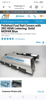

I found these online for my 392 Challenger from what I gather they will fit the jeep i have been thinking about it but was going to try sanding and painting mine first.
I know this has been a known issue w/ the 392 engine covers, but my search skills on the board were coming up empty. The engine covers on my 2022 had still looked pretty good up til now, but as I was doing some annual engine bay detailing over the weekend, the gold markings on my covers damn near all washed/wiped off with very little "cleaning" effort. Of course, I'm a couple months out of my B2B warranty now, so I'm sure its not worth wasting my time to try to get warranty replacements. Thinking about just buying a new set or getting the original ones painted, but I was mainly curious of two things... For anyone who did the warranty route (or bought new ones recently), do newer ones hold up any better than the original ones used back in the first couple years of the model? Also, if anyone else has taken theirs off themselves and replaced them, how hard are the covers to remove and replace? Any tips/tricks? Thanks!
