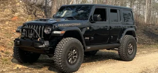

Lift height coming in much taller than advertised

It leaves me wondering what kit I actually have. I would say mine looks a little taller now. What is the gap between the front tire and fender flare?
Thank you for your response. I really appreciate it. I definitely got a 4.5 - 5 inches. I went from the stock 35s to 37 Nitto ridge grapplers. But this isn’t what I wanted. I do not like the look of it. I love other people’s on taller lifts. But I’m not loving it on mine. I wanted a minimal lift to accommodate the 37s and have no rubbing when flexed. The springs will never settle enough for my taste. When you go to pick your Jeep up after putting a lift on it and you’re not saying wow I love that then something is wrong and something has to change. I don’t love this Jeep like it is.

Okay, that sounds correct. I am right over 9.5" with a full load and winch.

Heres a picture of mine with 37s on the factory lift with a 1" front spacer and 1/2" in the rear. I wanted minimal lift on this jeep but still enough to clear 37s. Thats crazy you got 5" of lift.... What did you end up doing?

I am saying it's their 3.5" kit. It looks like the same height as mine. I actually love how yours looks but I understand it's not what you wanted.
Can you list the exact kit you purchased and take some measurements?

This is my Teraflex 3.5 RT3 kit that came out 3..5" plus another inch on the tires.

I didn't read the entire thread, are you sure the control arms were not tightened when the jeep was on rack? That will bind bushing and cause the jeep to sit taller
