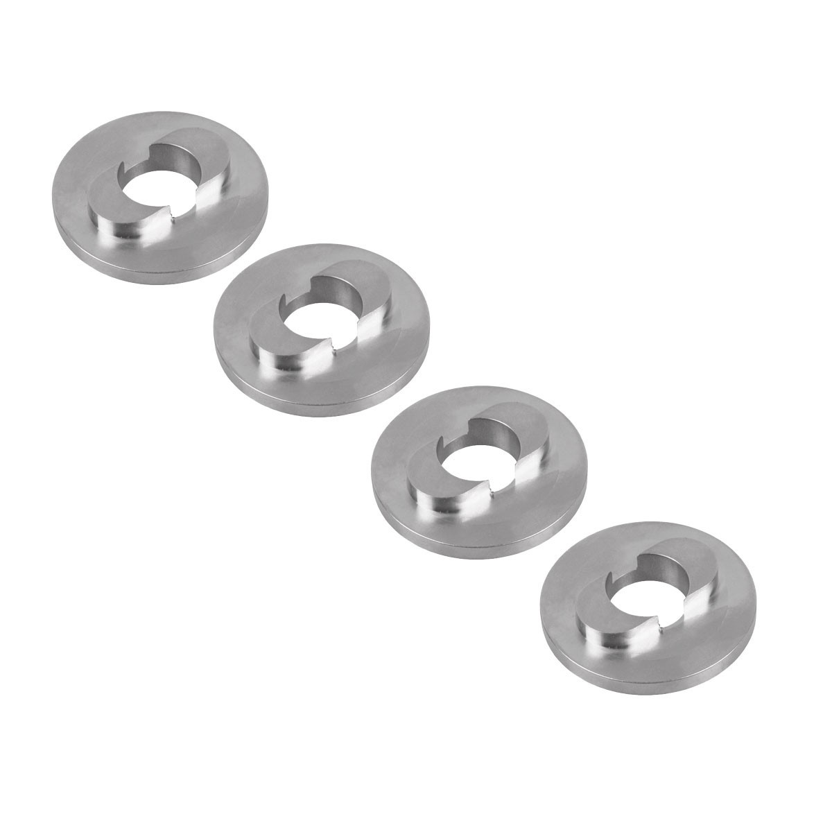

The caster adjusters work very simply. They used to be on all straight axle 4x4s due to tolerances at factory. The idea is simple. To increase or decrease caster all that needs to happen is lengthen or shorten the control arms. So a cam adjuster bolt is doing that at the lca connection to the axle. They are often called eccentrics. Because as you can see in your picture they are not round. So the act of turning the bolt moves the connection between the axle and the LCA forward or backward. Thus increasing or decreasing caster. So to make room for that movement on a JL/jk the hole must be elongated. It needs to be elongated enough to actually have an impact on caster. So .25-.35 inches. As you can imagine that sounds sketchy, If that gets loose or is jarred off road it slides even at 120 ft/lbs of torque that is applied. The cam adjuster is designed to try to stop it but once it slides, it always slides. And the connection of the LCA to the axle right there is critical for proper handling and steering, as you found out, hence your report of steering problems.
With so many aftermarket options for adjustable LCAs or geo brackets the practice of adding an eccentric has long been gone. And it is typically reserved for the good ole shops or dealerships, since mopar makes no LCA that is adjustable…. There is not anything that can be done now. if you look at that cam kit it is not compatible with your 392. So If you run into trouble there are a couple cam elimination kits out there for dodge trucks from synergy that you can try. But trade it in at the first hint of death wobble.

Absolutely. Geo brackets would have cost just a few dollars more than the cam kit. But if something truly needed to be exactly dialed in, a set of adjustable LCAs would been a 10 minute install and then a perfect alignment number could have been done in seconds. Welding as a fix is usually temporary

Those are tough questions. If you plan on staying at stock 392 height, the mopar 2” lift LCAs should get you a good amount of caster on their own. Geo brackets could easily be added and you could use the close holes to start to see if more caster is needed, and move to the second set to feel the difference. I would also try either of the fox TS stabilizers. The adjustable one might be worth the extra $ so you can see if stiffer or softer helps your feel. Fully adjustable LCAs are really nice if you truly want to dial in an exact spec, but there isn’t any of those mopar will cover under warranty. AEV geo brackets shouldn’t be a problem for your warranty.
Eliminating the elongated holes with might be better done with the dodge truck version of the elimination kit. Since it fills the entire space.
There will not be a cam elimination kit for a JL since it should never have them ;)
