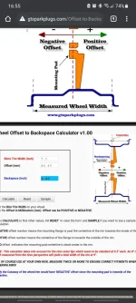

I just measured my own 392 rim and found it was a 6" backspace. I then saw the stamp in the back saying 44.45mm and put that into a calculator. Guess what, it really is 6 inches. I'm looking at a method wheel that is 4.5", -12mm so from what I can work out thats going to poke those wheels out about 1.5 inches further.
I was told that I will still need a lift to run 37's on this so I'm still considering a bead lock of 3.5" and -44mm. The lift that was suggested was a TeraFlex spacer lift that also lifts the lower shock mounts.
