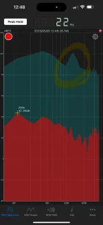

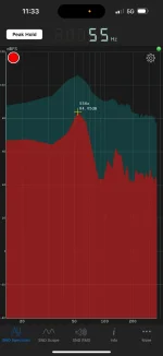

Is there drone between 1400 - 1800 rpm, low range boom in the 45-75 hz, on deceleration range with the MRT modifications? Also, no drone even when the system is completely warmed up after driving for 10 min?
This solved all the drone I had in the 1400-2000 RPM zone. The 120 Hz sound peaked at 1900 RPM but could hear it rise and fall in the 1400-2000 RPM window. You can see the before & after spectrum analyzer graphs I took. Look at the green peak section - you can see the 120 Hz peak is gone. The green is the "peak hold" taken from idle to ~3k RPM.
Also no drone when the system is completely warm.
It didn't totally mute the 45-75 Hz (you can also see this is still present in my "before" and "after"). What the MRT mufflers did was make it so it is no longer bothersome though. Overall sound is much better managed.
With the stock Borla S-Type I got a very boomy sound at idle when warm as well as some deceleration boom. This was in the 45-75 Hz range you mentioned. My family would plug their ears due to the boom sound at idle as it was so loud at times (worse with roof/windows open). The MRT mufflers knocked this down to a completely tolerable level.
