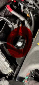

Added a disconnect to the winch power wire. Found an easy mounting location that is easy to access and is out of the way. I pulled the factory bolt and drilled the center of the bottom cover on the disconnect and mounted it . I then wired her up and attached the disconnect body to the mount and installed the 4 Allen head retaining screws . Seems like a clean install.
