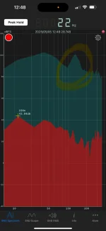

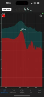

My Problem with Borla S-Type (drone):
I had some boom and drone that peaked right around 1900 RPM (120 Hz tone). It’s not obnoxious but it’s definitely noticeable and enough to be bothersome.
The boom sensation / drone is more pronounced in the rear seat. Others might be a bit less sensitive than I am, but it’s noticeable. See screen shot from spectrum analyzer app - it’s the peak right around 120Hz that is most problematic (green part of chart, not red part).

4. It smoothed out the booming drone tones that happened around 1900 RPM (specifically the 120 Hz / 1900 RPM peak).
