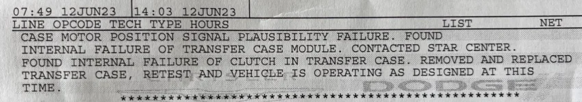

Transfer case ordered today
Transfer Case finally arrived. If this doesnt fix my Serv 4WD issue, im afraid im gonna have to file lemon law. Keeping my fingers crossed.
Transfer case replaced today. So far no Serv 4wd light.
Why does it take 10 visits and 25k miles to get this done when they prob knew from the start what the issue was.
Speechless with the level of customer service I have received. Beyond pitiful.
