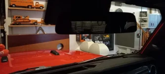

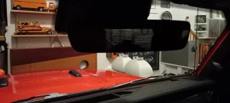

Flipped mine, moves the mirror up 3/8".
Had to pop the ball out of the socket.
There's a small molded-in key in the plastic socket that you have to carve out (1/8 wide).
Minimal gains for the effort.
Before @ 2.12
After @ 1.75

Thanks for trying. Bummer, 3/8" is not a lot.
Thanks. I was going to try this myself at some point. 3/8 is not much but it's some and might make a bit of a difference. How long did it take to to disassemble, modify it and put it back?

It took roughly an hour. But that's mostly due to time figuring out how things were joined. It wasn't obvious and didn't want to break something. I ordered a mirror assembly (mirror + post) to mod, since I can't leave things alone.
