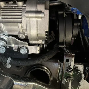

Hey there - what did you use for cooling fan? Curious on set up as I am now seeing the warning light (despite sub freezing temps and street driving).
Happened to me twice. Once in Ouray doing a long climb to Clear Lake. Second time was on hwy285 for a couple of hours. Both times all it took was a small time to cool off. After the second time I checked the fluid level which was a little low but not bad. Added a little fluid and haven't had it happen in the last year and a half.
I'm on my 3rd power steering pump at 11,000 miles. If they get hot to many times they start leaking fluid out the motor. After I put the fan on I've never had the light come on again. If you keep your tire pressure above 15 you are usually good. I run mine at 10 PSI on 37x12:50R17 tires.
