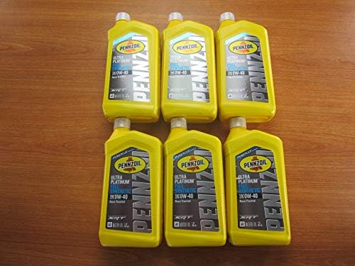

Pennzoil 0-40 SRT
maybe next summer ill try some 5w-40 being here in PHX
Thankfully it wasn't like 120s hot this year only like 110-115.
IDK why but for some reason the idea of not running the recommended viscosity in this motor gives me anxiety.
