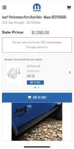

These rails do not fit according to this Mopar parts website…

I'm 99% sure those will fit.
It's the same exact attach points as all MOPAR JL rails/steps including the Rock Rails that came on the 392 from the factory, basically 3 body bolts (13mm) and 6 pinch weld bolts (10mm):
In fact they are so similar that MOPAR uses the same installation instructions for both the standard issue Rock Rails and the Performance Rock Rails your talking about 😆
I bought a set of the MOPAR Side steps (MOPAR #82215164AB) for the wife, kids, and dog to get in and out. They look good (IMHO), they are well made in Canada and won't rust. Best of all they are wide enough to make it both easy to get in/out and they block all the dirt/rocks that are kicked up by the front tires from damaging the doors and rear fender all winter long. It took me about 20 min to swap from the side steps back to the standard rock rails. So I can just swap them out for the OEM rock rails the night before heading out on the trail. I bought them at my local Jeep dealer and if you download the MOPAR app there is a 15% OFF coupon that made them cheeper than anywhere online. Also in the 1% chance that they don't fit you can just take them back.

I also wonder why the MOPAR websites say that these won’t fit a 2021 (or anything but a 2018) JLU? Quadratec’s website says they will fit a 2018 to current JLU.
