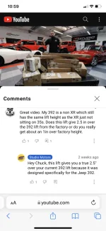

@Damnright thanks for the side by side comparison pics. I’ve seen a few lifted rubicon and don’t feel my 392 XR any taller.
@7.62x392 1.5” seems more reasonable. I watched Dave explaining the RK lift kit that he picked:
and he also answered in one of the comments that it’s a true 2.5” lift over the 392 lift. So it depends on the actual kit I think.

I saw this video. I don’t think this guy knows what he is talking about. I’m almost positive the 2.5” RK lift for the 392 is still 2.5” over the factory non-392 Rubicon lift, not 392 factory lift, so would net about an inch on a 392 (anyone on here with the RK lift maybe you can confirm?). It’s 392 specific because the springs are dampened to be stiffer to carry the load of the HEMI. Same with the 392 specific Clayton lift I just got. It’s a 3.5” lift but only gives 2” over the factory 392 lift. Says right on the Clayton website. Note a 2.5” lift may increase lift height a little more on a vehicle without any armor or a winch, but I doubt it’s 2.5” over the factory 392 lift.

This right here from the RK website confirms my thinking, based on the tire specs this tells me it’s an inch over stock 392. If it were 2.5” over a stock 392 you’d be able your fit 40s without a fender chop.
“Tire Fitment:
Rubicon with Full OEM Fenders
37” Tall Tires (3” Bump Stop Height Recommended)
Rubicon with Trimmed or High Lined OEM Fenders38” Tall Tires (3” Bump Stop Height Recommended)”
