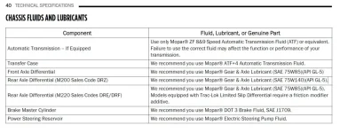

I have nearly 10k miles on the 392. I'm wanting to replace my front & rear differential oil. Regarding the rear dif, the 392 performance manual states to use 75W140 if you have a M200 DRZ sales code. If you have a M220 DRE/DRF sales code you're supposed to use 75W85.
I'm going through all my paperwork with no prevail. Short of actually calling the dealer, where/how do I find out if I have the M220 or M200?
Thanks in advance,
~justin

You have a 392, they all have M220. Only difference is 2021 have a drain plug 2022 don’t.

Thank You for the reply. With that, I assume I have the Trac-Loc limited slip, and as such I'll require a friction modifier.?. Any suggestions on a brand to use... or perhaps use gear oil with the modifier already added?

No, Rubicons do not have limited slip. Regardless of engine. One of the reasons I have always bought Rubicons. I hate limited slip diffs in the snow and ice.
So, no friction modifier to add. That being said most quality synth gear lube includes It.
Also 2022 M220 will have to change fluid the old fashion way. Pull the cover, which many will say is better than draining. But if you just want to do a quick drain and refill since you forded a river or something, quick change it is not…. No RTV tho, that was a pain. They have reusable gaskets.

Last quick question. I've always been a Lucas Oil fan. Think it'd be ok to go with a synthetic 75W90? This verse the recommended Mopar 75W85...

No problem. 75W85 is usually a traditional lube, where 75W90 is typically synthetic lube. I would always recommend a synthetic for diffs since they don’t get changed as often.
