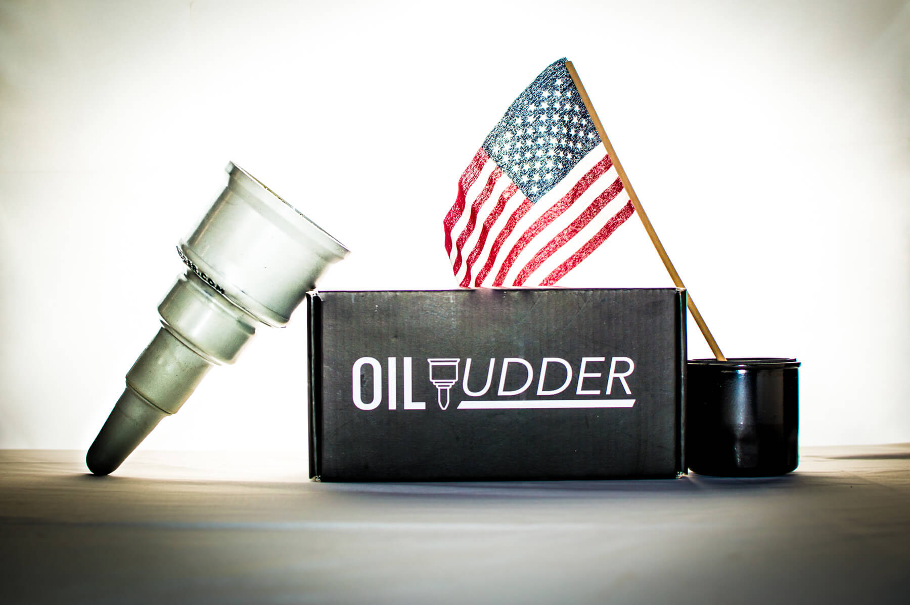

Use the oil udder…. Cuts down on the mess quite a bit. Spin the filter slightly loose, udder magnets to the filter and lets it drain with the attached tube into a pan. Once it’s done just take it off in the udder and fish it out into a trash bag.
